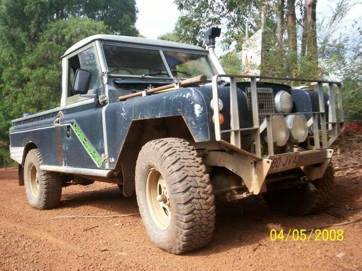

    I would buy series 3 door bottoms (which are virtually identical). If you don't want to use the SIII lock assembly you will need to modify that part.
    Then it is simply a matter of finding some perentie door tops SH - or get an alminium fabricator to make some.
    And before anyone says it won't work or they don't fit:

    umm...
    one reliable source say the prenetie doors are infact SIII and bolt straight up
    another source attempted to fit a SIII door to a perentie and the door strike didn't line up
    so I figure if somebody would be kind enough to post the part numbers I can be sure

    If you are happy to use SIII locks and strikers then it will all work fine. I don't know what the perentie use, but the one-ten/county locks are very different to SIII - I have never checked if they are interchangeable.

    Yes series 3 locks are the same as Perentie door latches/locks
    I've put new ones on mine
