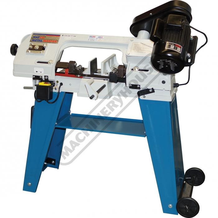

    I have both.
    If the tubing you'll be cutting is steel, I'd recommend the drop saw.
    The Chinese bandsaws can't, in horizontal mode, cut short lengths of steel. The clamping vice is very limited in what it can hold. Also, often when one is trying to cut at an angle, one simply cannot clamp the material. It's hard to describe without showing you what I mean.
    The bandsaw is great on thick bar stock or alloy. It's slow but one can walk away and let it do the job. It's also quiet when working in the garage late at night - important when one has nearby neighbours.
    Adjusting the blade so it doesn't come off can be a trial!

    If you think you want a bandsaw, take a short length of steel tubing into a store that sells the saws and play with holding the steel in the vice while you plan cuts. You'll soon see what you cannot do. Actually try the vice, it is particularly useless on angle cuts.
    Mine is similar to this design. Probably identical except for paint. https://www.machineryhouse.com.au/B002

    30,704
    That saw is a big step up from mine - both in capability and price!
    After getting mine set up, it rarely breaks a blade. I have more problems with the blade coming off.
