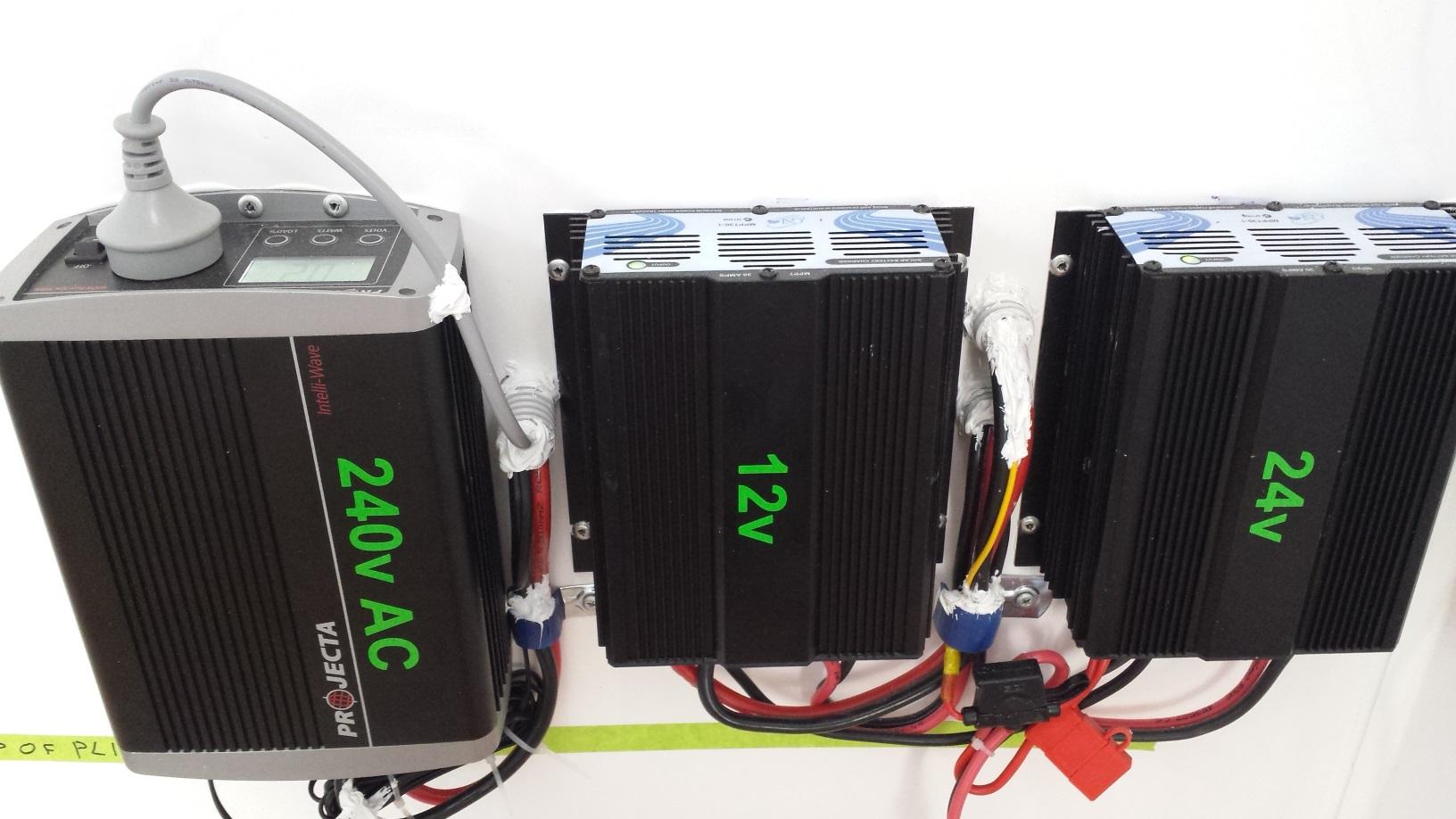

    A 30A MPPT for a 120W panel is sort of overkill. I am running 6 100W panels through a GSL 30A MPPT controller, and that is comfortable.
    If you want a true MPPT controller, look at these guys: GSL MPPT
    Industrial quality and made in Australia. They do 12A 20A 30 & 60A models.
    I am using 2 of them in my MAN:
    HTH
    David
