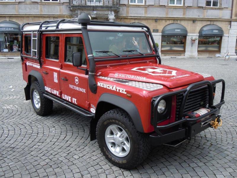

    Sorry Pete757 but working interstate means I will be able to post some pictures of the parts but it will take me a few R&R's to get it mounted. I will keep you updated and I attached a pic of a cage I build. Similar to the NAS.m

    Quote Originally Posted by 100inch View Post
    Looks great!
    Interesting, I am curious, can you explain how any vertical forces would be transmitted downwards direct to the chassis rails using body mounting points? I guess I was anticipating the hoops being somehow tied directly to the chassis rails...?
