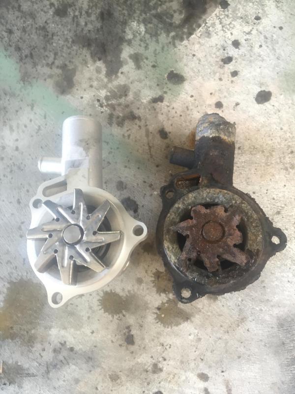

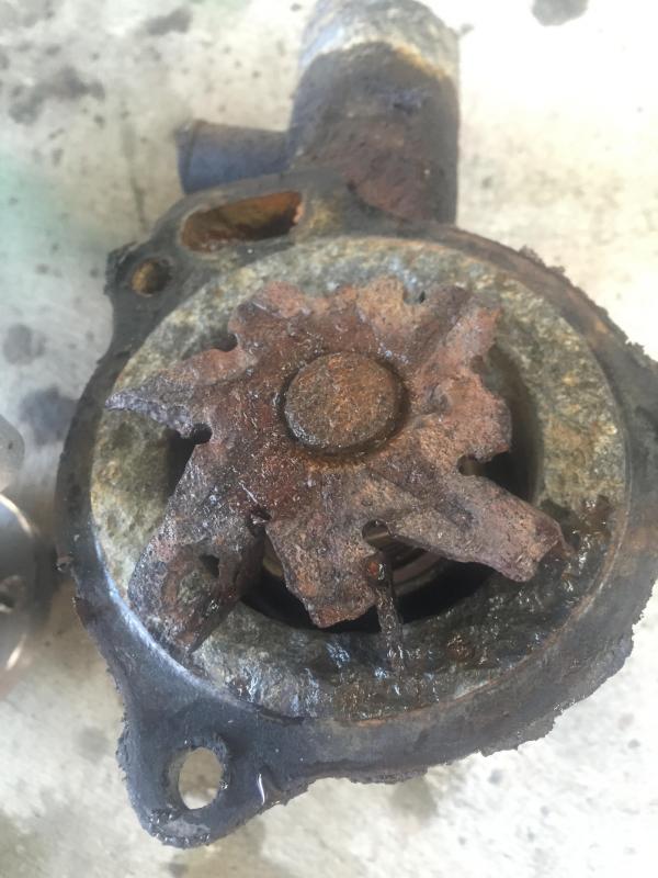

    Thought I would share pictures of my water-pump that I replaced over the weekend. The Land Rover had been getting very hot when in traffic - really hot! There was also a groan / rumble coming from the water pump so I decided it was time to replace. I had read various threads elsewhere that the replacement pumps aren't as good as the original version but I think regardless, this should make a big improvement:
    I was pretty surprised by how bad it was! Needless to say the replacement has made an instant improvement to running temperatures and actually the engine is running much happier in general. I am amazed it hadn't suffered more with over-heating given that water would have barely been circulating through the system. I guess the previous owner had been using straight water as the coolant. I have now flushed the system repeatedly and replaced with a proper anti-rust coolant.
    Also fixed the leaking exhaust.. the engine is so much more refined now. A great weekend of tinkering!

    That's great advice, many thanks. I was considering fitting an electric fan behind the front grill to give a little more cooling ability should it be required. I think the previous owner may have fitted one many moons ago - the front grill has a circular hole in it.
    Mine has the sump bulb at the back, I haven't noticed any issues with that but then I haven't done much extreme, prolonged offroading.
    I am really amazed it wasn't over-heating more often with the levels of corrosion seen on the water-pump.
