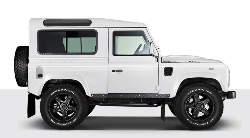

    Get the flares painted too, that 90 in the photo with the wheels looks unreal!
    I am thinking of getting the flares wrapped in white vinyl so when the inevitable occurs, I can just have it replaced without having to mess around with painting.

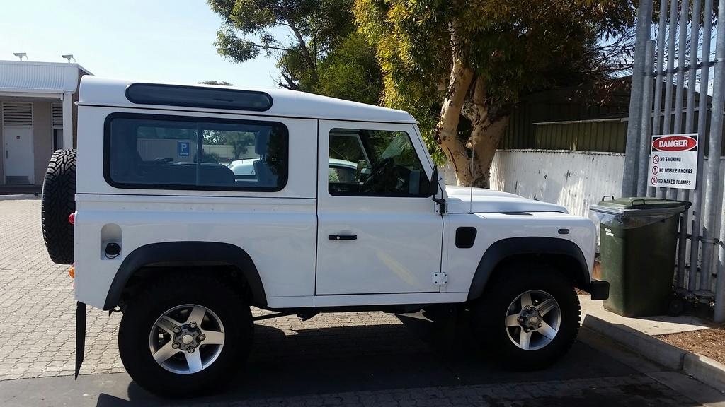

    SKC, sorry a bit off topic but did you have any troubles running 285's with standard wheel guards and what offset did your rims have? Thanks
    Pete

    Im thinking i might get a spare set just for fun in 285. Did you have lift kit on the TD5?
    will it grab on the stock guards and does it stick out of the arch much? sorry for the Hi Jacking.
