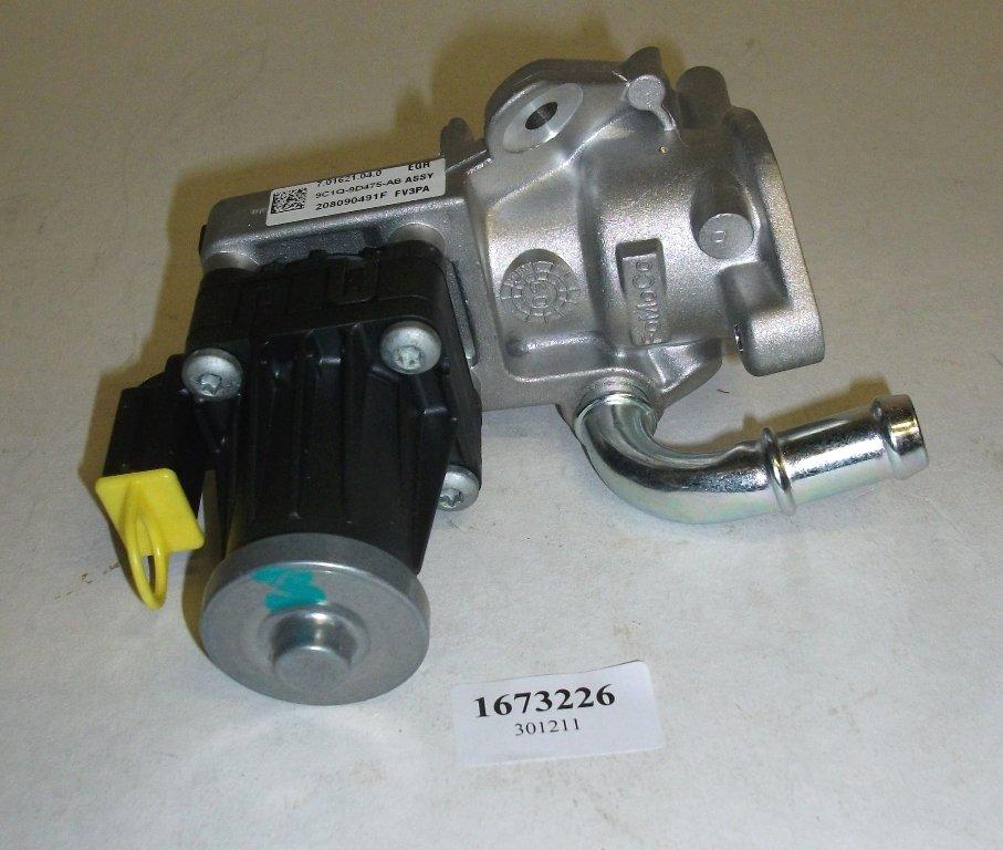

This is what the valve on the 2.2 puma looks like.
Its mounted towards the back of the engine on the passenger side. The yellow cap is where the electrical connector goes. You just need a flat blade screwdriver to release it.
