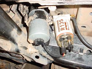

    Ean Austral Guest
    This is a pic of a 2006 (I think ) D3 with a extra filter added. The forum member who emailed me this told me he never had any issues with the flow rate. He said the water senser had an idiot light installed inside the car for when it was sensing water.
    Just needs to be shrouded correctly , sadly its the earlier type filter than my 2008 but it can be done.
    Cheers Ean
