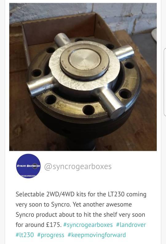

    Anyone heard much about syncro gearboxes duraspec lt230 offerings? Ultra spec is offroad only and basically spool centre.
    Also of interest is the 2wd selection they are making or have made im not sure how this compares to ashcroft or avm 2wd kits
