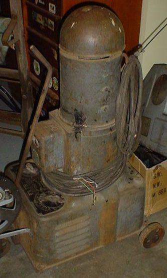

    Quote Originally Posted by rick130 View Post
    Except you need an AC TIG and a lot of power, an inverter DC TIG won't do it.
    god bless the old motor driven dc..
    can hear it whining in my sleep
