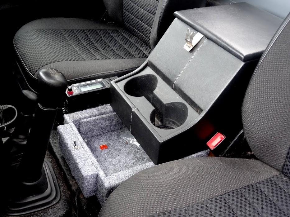

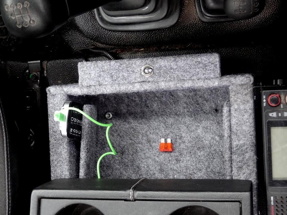

    Hi,
    Some photos of the sub-cubby box.
    It is made of rough pine and plywood, but covered with boot liner carpet. Its main purpose was to get the cubby back a bit so I don't get my left elbow whacked when the lid is opened, and to make more space under it for some wiring.
    The switch at the front will control all the 12V outlets that come off the back of a Traxide SC80. This power is either from the camper battery when the slide-on is attached, or power from the cranking battery until it gets down to the SC80's switch off point.
    The phones etc are held in place by two lengths of plastic garden edge on either side. I'm pleased with how they keep stuff in place. There may be other places I can use that idea.
    The carpet stops abrasion, and hides a multitude of ugliness.
    I will put the USB plugs back under the overhang, and just leave the cables accessible to charge stuff.
    I'm still sorting what and how I want it, no doubt it will get modified.
