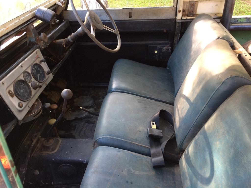

So I just got this 2a, plan to get it on the road asap and eventually restore to its military spec. Chassis number is 25306585b, engine number 25174069F.
Engine number matches up with ARN 113-144. The chassis number is not showing up on REMLR, but chassis number 25305685b does and matches the engine number, so thinking there might be a typo in the database.

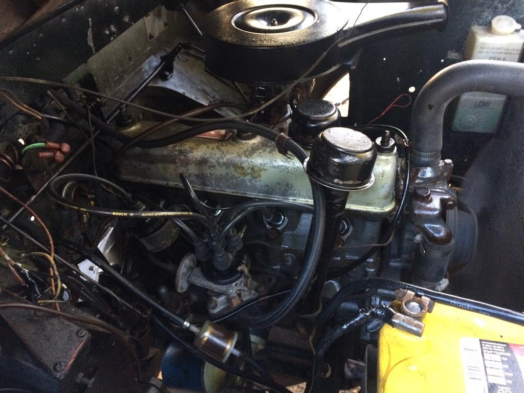

So started giving the old girl a cleanup and service to start with. The engine ran with a a miss on one cylinder, the brakes didn't work either.
ripped all the floor panels and seat box out and started degreasing
Gave the engine a quick service, new plugs and leads. No.4 cylinder was low on compression, this was eliminated after adjusting the valve clearances no.4 was tight allowing valve leakage. Running like a sewing machine now

						SubscriberHey Paul, thanks for sharing. Got to admit, none of the mods are my idea of ideal either but it looks like a great rig. The gearbox has cleaned up beautifully. Please keep posting your progress.
