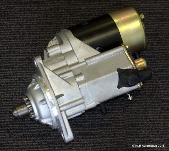

    One of these? KLR Auto at South Windsor have them. I saw them in boxes out there last week. I don't know when KLR are back after the Xmas break.
