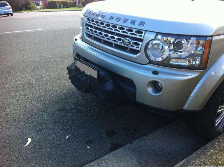

    Nah there's one that goes behind the bumper & you fold down or remove the number plate

    I bought one of these for my D4:-
    https://www.lrdirect.com/DA7537-Discreet-Winch-Mount/
    AUD $514 delivered
    No doubt the D3 version is also available at a similar price.
    Looks to be the same one as in the Bearmach catalog posted above.
    I've not fitted it yet.
    One thing that concerns me is that fitting these required removing the internal metal bumper reinforcement tube.
    The Winch bumper replaces this at the front of the vehicle but this does not extend to the area under the headlights (which is protected by the original metal bumper).
