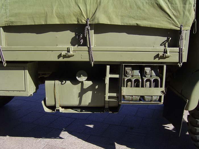

    army did (still does ??) transport them as you propose.
    30,704
    Paul, that's on edge, not on side.
    I assumed he meant on the larger flat side. I carried one on the roof of my RRC like that.

    Homestar's Avatar
    Homestar is offline Super Moderator & CA manager Subscriber
    Aug 2010
    Sunbury, VIC
    20,105
    As mentioned, there are plenty of military vehicles (including my 101) that have jerry cans mounted on thier side. In the 101 holder, I actually have to put the can in upside down and then it swings up to hold it sideways. Either full or empty it doesn't leak, and neither shoud one in good condition. As mentioned though, if the worst were to happen and you had an accident and rolled the vehcile - would you want them flying around the back seat with the kids?
