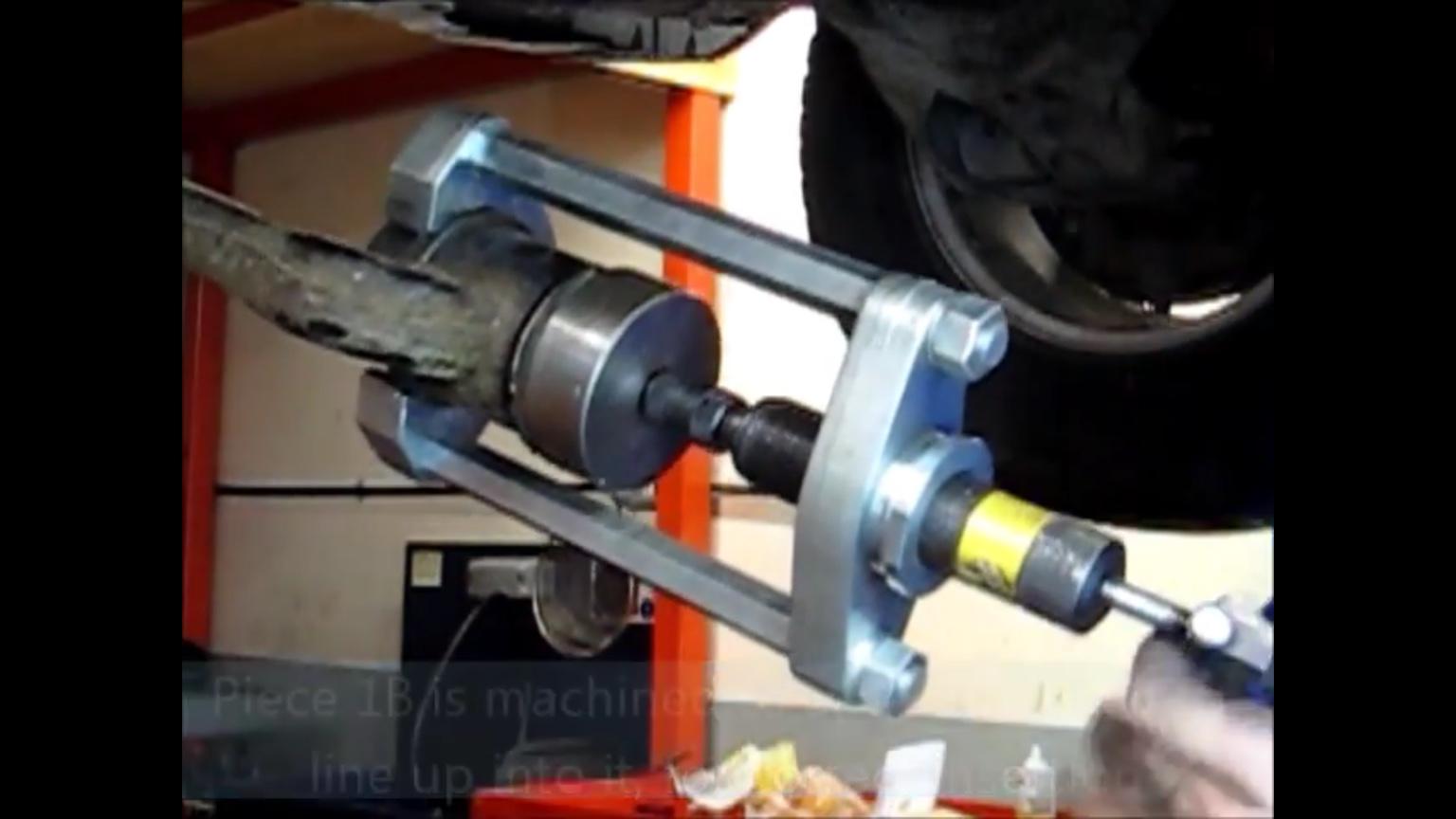

    I'm currently waiting on my press to arrive from the Front suspension 'squelching'. Then it's my turn to replace lower bushes...
    Fun times - I should have specified it was the sway bar bushes in this case. What surprised me is how much quieter the cabin is and how much vibration they're soaking up out of the driveline.
    Pressing LCA bushes could be a tidy little home business...

    This is what I'm waiting on...
