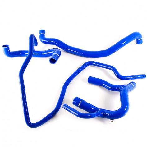

    I want to silicone-hose my coolant system (already upgraded the intercooler hoses) to avoid those hose bursting and stranding situations. I found this set: DIRENZA LAND ROVER DEFENDER 2.5 TD5 98-07 SILICONE ENGINE RADIATOR RAD HOSES HOSE KIT . (Vehicle: 2005 110 TD5)
    It's a three piece set that looks to cover the main components, but after having a look under the bonnet I noticed that there seems to be a few little ancillary pieces.
    -Does this kit cover all of the cooling system?
    -Am I correct to assume that the coolant hose system is only as strong as the weakest link, and that if all the pieces aren't replaced, that there is little need to replace any of them?

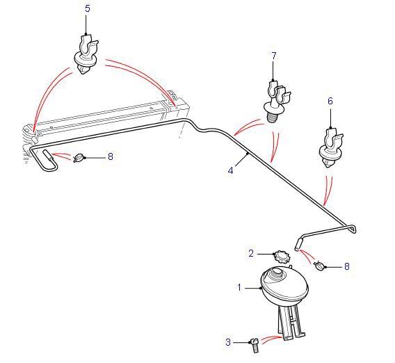

    Here's the cooling system.
    And the overflow system.
    And here's what you're looking at:

    If I can't replace all the coolant lines with silicone, then I figure that I would still have a 'weak link' in the system, and so better to keep consistency with the materials being used, right?

    Materials being different doesn't make any difference.. The silicone hoses should last longer - which means you'd be replacing less..
