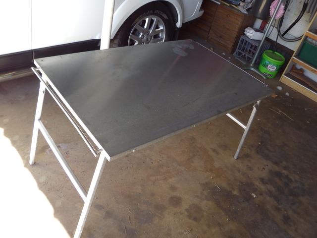

Should be better than mine, as it's the newer version that mounts lower to the roof, and mine is not too bad for wind noise (I've had worse). Mine is the older version on legs which sits a bit higher than that one (and is also the full length version). I like the look of the lower mounting, but I'd hate to try to polish the roof with one fitted - mine is bad enough. Also, you can't fit the optional camping table that I have under the lower mounted rack - there isn't enough clearance.

If you put some spacers between the rack and the legs (4mm) as well as bend the table mounting brackets up a little, the table will fit without rubbing on the roof. Also add some marine carpet to the sides of the table mounting brackets and you will have a noise free experience in general
A handle on the rear of the table makes it a lot easier to insert/retract the table. Cutting the front of the table mounts and making the initial opening a bit wider helps too. Only needs 20 mm.
The table combined with the rack is amazing. I generally love the whole thing.
Mine came with marine carpet already installed in the slides, so once it was all installed and adjusted to a tight fit, no issue with rattling and noise.
Bathroom towel rails from Bunnings make good handles (and give you somewhere to hang the tea towels when using the table).
You learn very quickly about the need for at least one handle the first time you put the table up under the roof rack and get your fingers in the wrong place.
