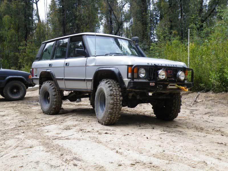

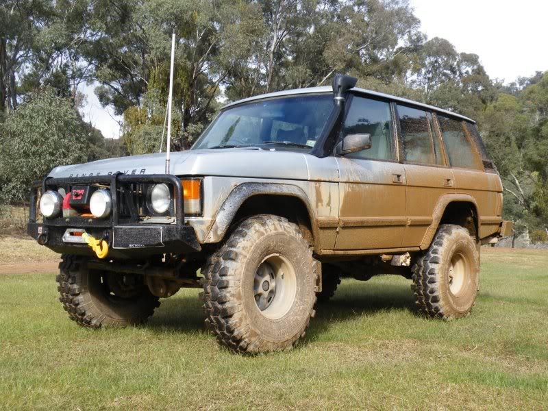

    I ran q78s on my Range Rover. Diff clearance and tread depth was good and they are a little less extreme than centepedes.
    I would not recommend for daily use. You could do it but my simex centepedes I have now have better road manners and we all know there nowhere near a good road tyre!!

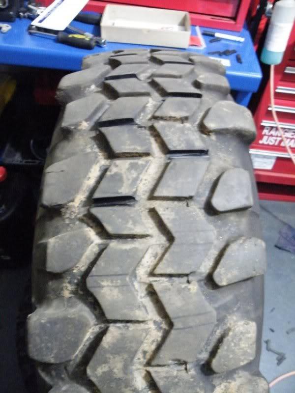

    You can see were I grooved them here. Half done. Not essential but This made them better in the hardpacked Victorian clay!

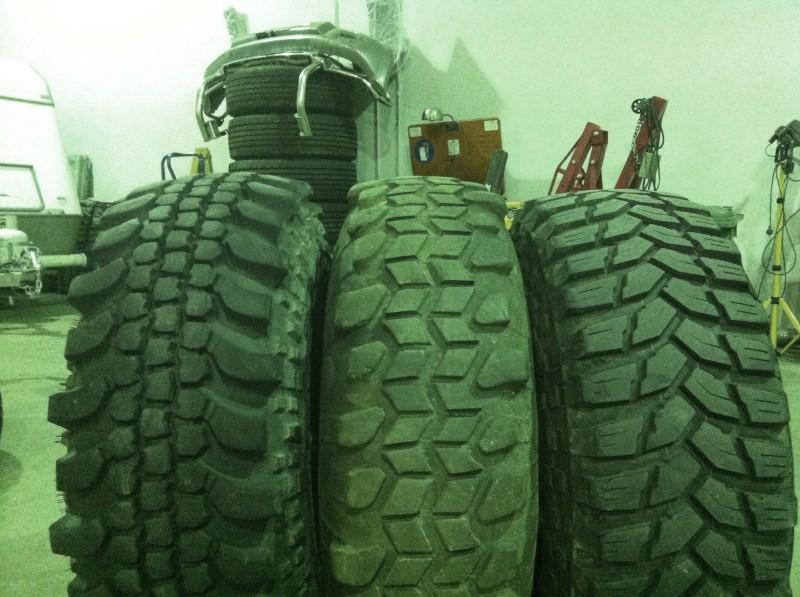

    For reference L to R all on rims.
    36x12.5x15 centepede, my half worn q78 and 35x12.5x15 radial trep.
