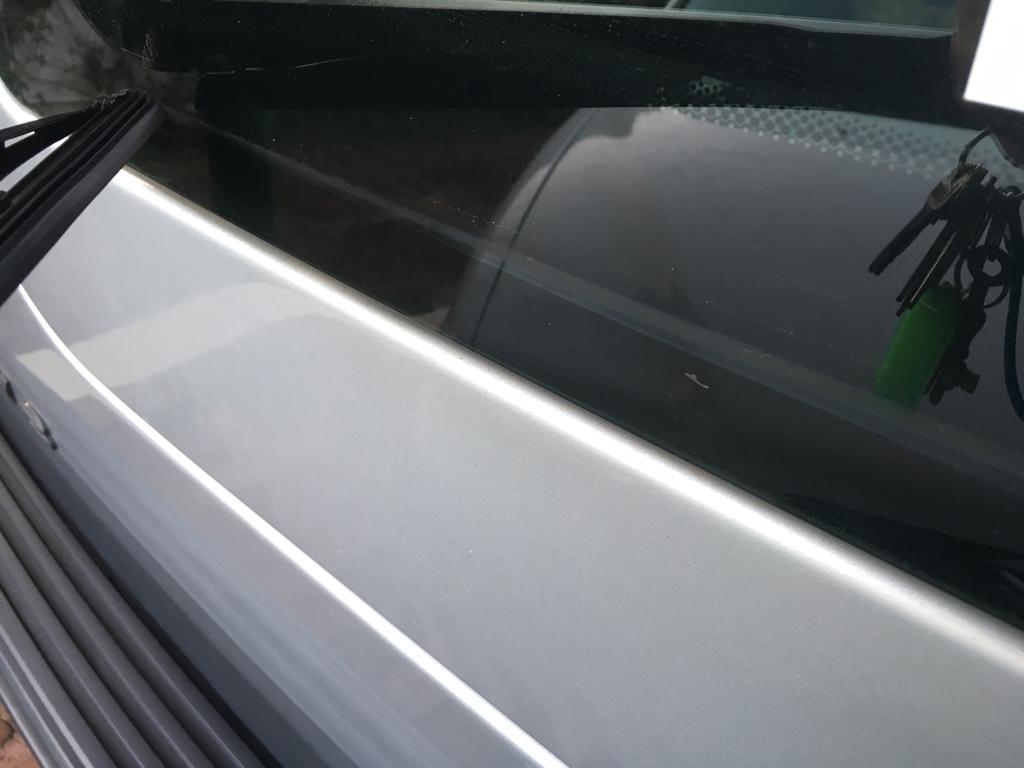

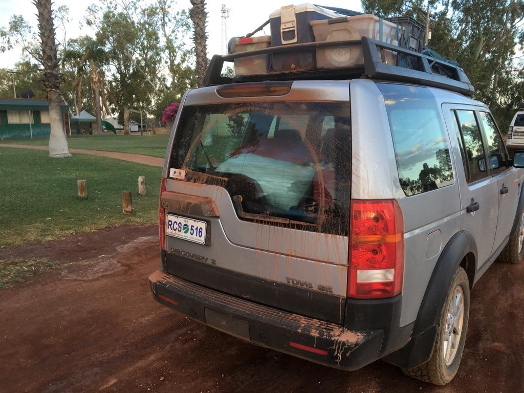

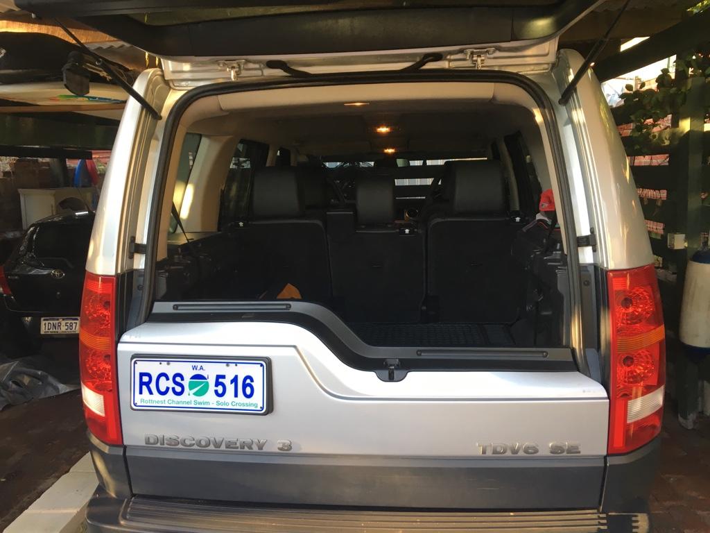

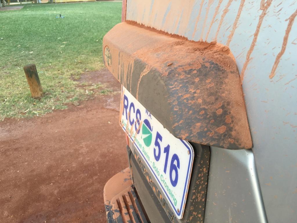

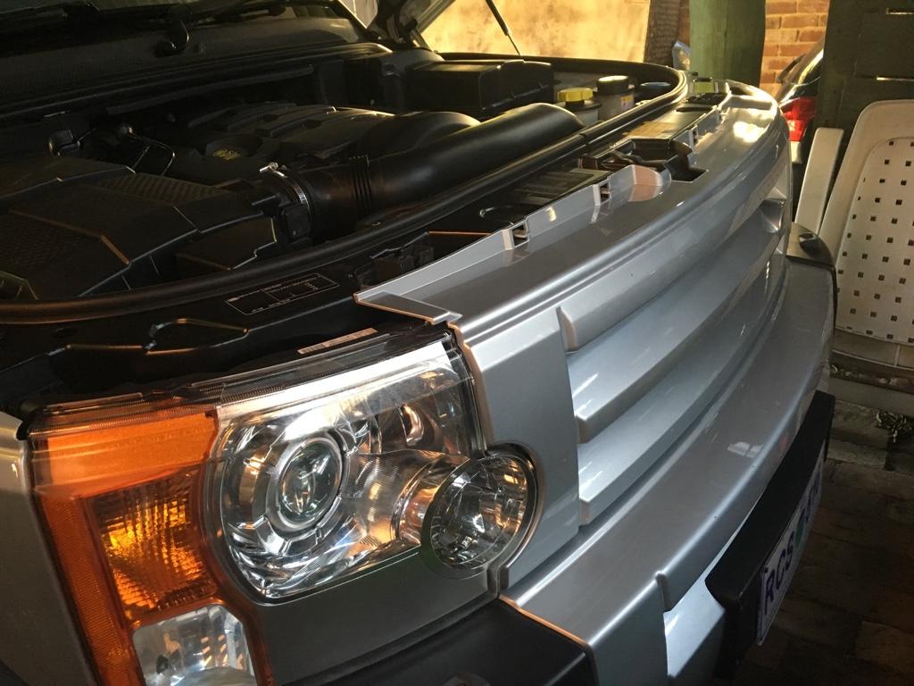

    After cleaning up after running fast on red dirt roads I noticed a few interesting bits of wear and tear.
    The back tailgate collected a big pile of dust in the lip at the top where the hinges are. Rinsing turned this to mud.
    After washing, where the upper tailgate seals land on the lower tailgate have worn through the paint at the outside ends.
    The rear windscreen wiper has scored the glass where it has rubbed dust constantly in corrugations.
    The amount of dust that got into the back corners from behind the indicators was pretty surprising and took a good clean out.
    I'm sure some contact clear could avoid this for those interested.
    Good old CT18 has cleaned it up well

    I like you roof rack

    It's hard to imagine a closer fit than that onto the LR short bars.

    That mark on the rear window where the wiper and dust have rubbed will polish out with some toothpaste on a cloth.
    To prevent same happening again what I do is put a strip of electrical tape on the glass under the wiper rubber when there long dusty km involved.

    Worked a treat! Thanks
