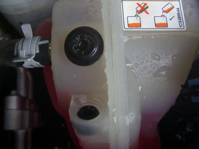

    My recent coolant leak turned out to be coming from the bleeder screw in the top of the coolant reservoir. I suspect that someone may have over-tightened it at some time, and the head of the screw split off the body - was still in position until I touched it with a screwdriver, when it fell completely off.
    Coolant ran down the side of the reservoir (of course on the side that you cannot see), then along the hose from the bottom of the reservoir (which is where I initially thought the leak was coming from), and then out the bottom of the car. Puddle on the shed floor was almost directly beneath the leak, but a bit further back. Looking under the vehicle, the signs were very similar to yours immediately after driving the vehicle, as wind had blown the leaking coolant further back.
