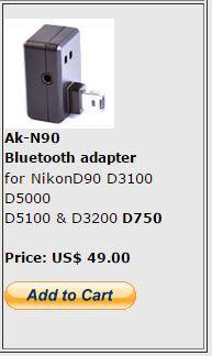

    Googling AOKA led me to their website and it looks like I can get things to work like I want it to.
    Camera: I'm looking at possibly the D750

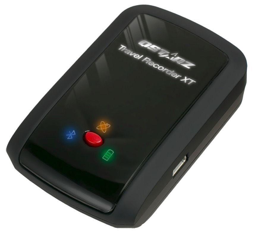

    My GPS:
    Qstars BT-Q1000XT from clueysolutions
    and to pair them via bluetooth I can use..
    There is a youtube clip of it working here
    And the devices will pair with a lot of bluetooth gps units.
    8<---------------------------
    AK- 4NII, AK- 4NIII, AK- N90 & AK- N7000 compatible with most Bluetooth GPS Receivers which have following 3 features:
    (1) Compatible with Bluetooth Serial Port Profile(SPP)
    (2) Support NMEA0183 data protocol
    (3) PIN/Passkey: 0000

    On the D750 type camera tho, the AOKA connected to the body isn't as unobtrusive as it's connected to the side of the camera .. thus affecting handholding. That's about the only downside(which is minimal).
    For GPS logger, I'm thinking (for myself) I want a Qstarz BT-Q1000XT, and mainly for the added ability of it's software.

    There are a few other brands of Bt GPS dongles for the Nikon system, and the most famous brand is the 'legendary' Foolography.
    But wayy too expensive for my taste!

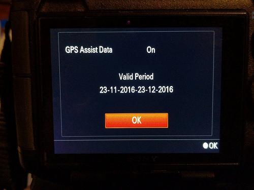

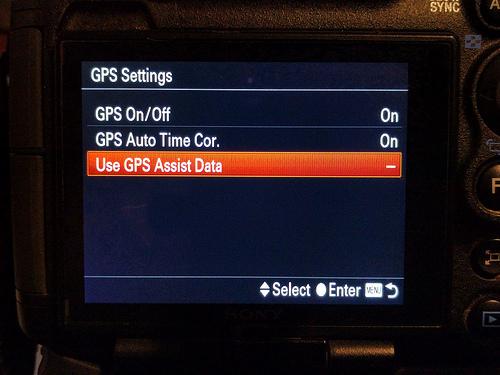

    Hey since we are talking about GPS units and cameras..
    For people with a SONY camera with a built-in GPS unit, there's a way of minimising the GPS fix acquisition time. Sony provides a file for download from their Japanese site, that basically contains the GPS almanac for the next 30 days. You store it on the memory card and it saves the GPS unit having to spend 2-20mins downloading it from the sat data (depending on how long you've had the camera off and how far you've moved while it's off).
    To use:
    Download this file. http://control.d-imaging.sony.co.jp/GPS/assistme.dat
    Open the memory card on your PC.
    Browse to PRIVATE/SONY and create a sub-directory called GPS
    Copy the assistme.dat file into PRIVATE/SONY/GPS
    Put the card back in the camera and turn it on.
    Checking the GPS assist status..
    You should see the dates that the file is valid for.
    Does anyone know if Canon or Nikon offer the same sort of thing? A lot of my photos don't have geotagging because I never gave the GPS time to get a fix.
    Now they don't have it because PS strips it off during export.
