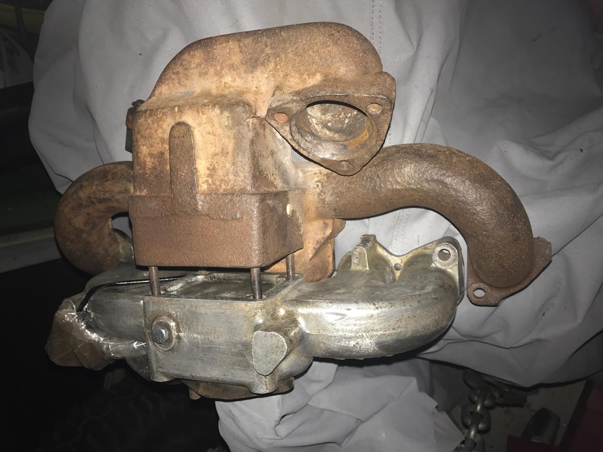

    May 2014
    404
    'Berty' - 1960 Series 2
    I have serial 143001010 ex ku ring Gai case trust vehicle its original engine long gone but have the original number I ended up finding a 59 series 2 engine and still has the swan neck manifold to exit thru the guard
    The swan neck manifold for my 1960 series 2
    1960 series 2 143001010
