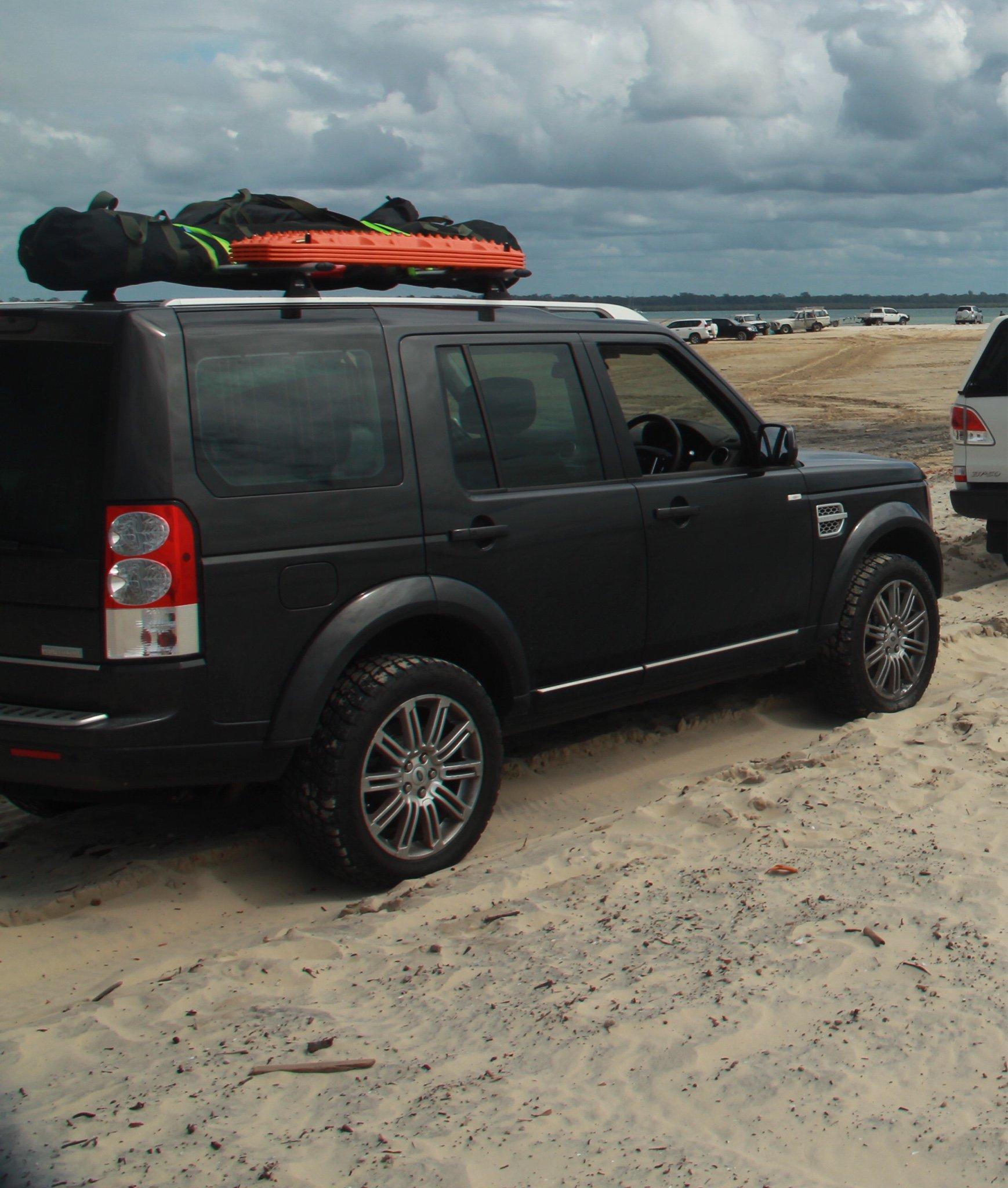

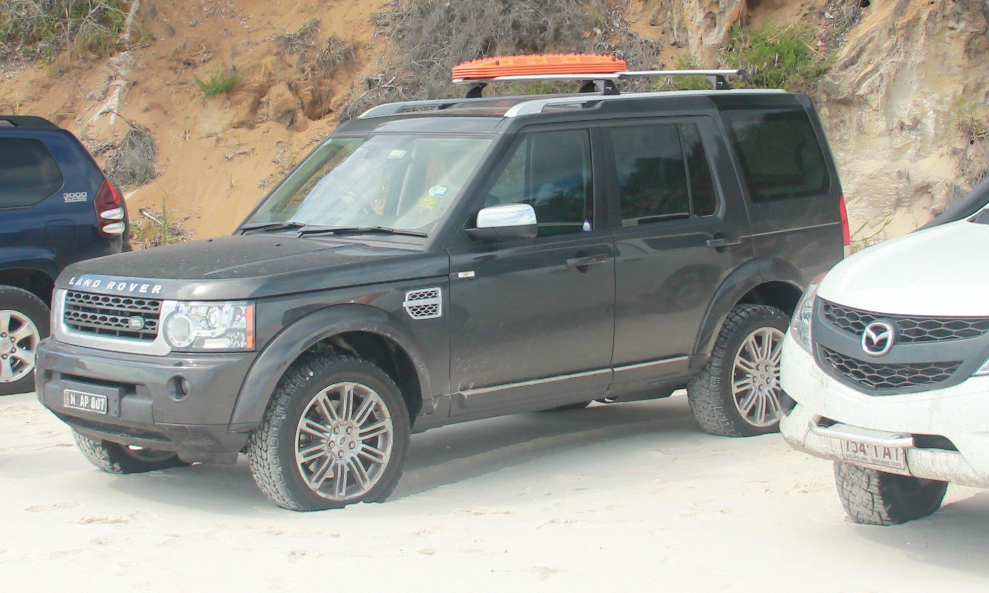

    I do differ from you in that I have the full length LR rails but the two bars are generally located in the back section of the vehicle. Let me try and find a pic to show you
    Jan 2013
    Ashgrove Brisbane
    94
    Quote Originally Posted by Aussie Jeepster View Post
    That is what I wanted to hear! Are your 2 bars just at the back, or do you have one at the front (on higher mounts) and one at the back?
    Pics attached, bars are about 840mm apart to suit the maxtrax pins. I used to have them a little bit further apart but not much.
    576
    1.13 MB
