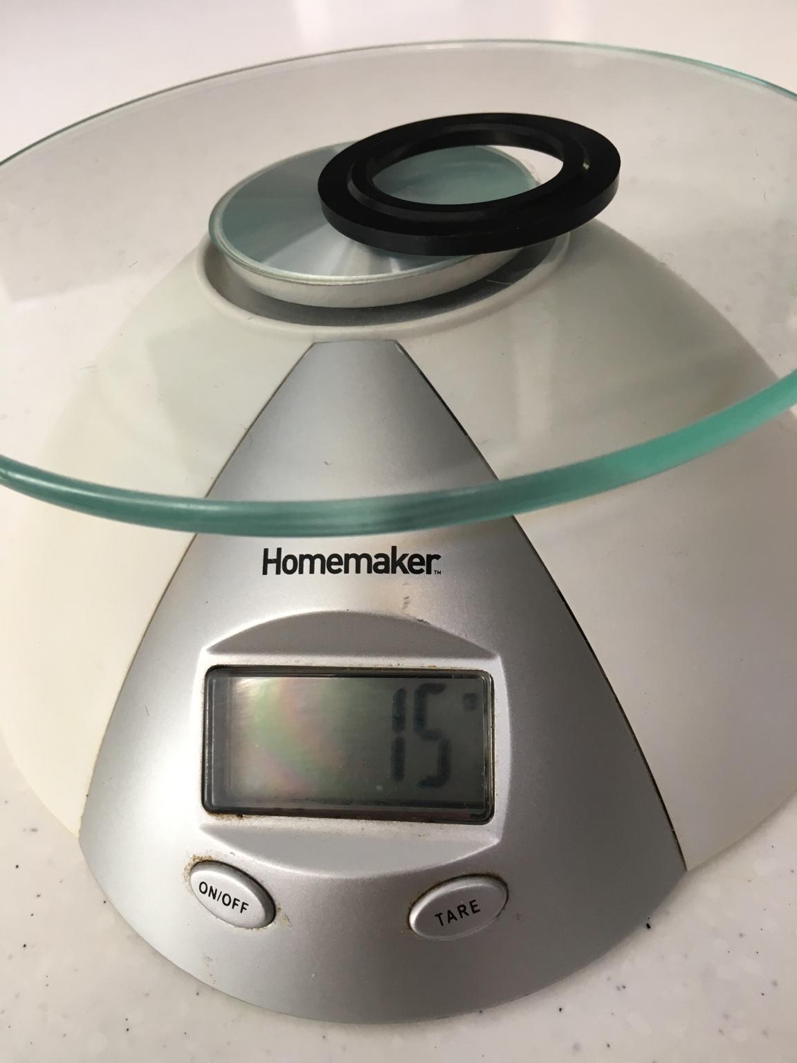

    My 130 project reached completion a little under 2 weeks back and during the build I spent rather than skimped on parts.
    Every thing ordered was typically genuine or an aftermarket upgrade.
    Ie axles, drive flanges, trans hoses.
    I ordered a quantity of genuine parts from the U.K. that were stupid price here in OZ
    Amongst them I added in a power steering box rebuild seal kit, simply because I was paying freight anyway and the supply was specified as genuine only.
    It showed up marked as OEM quality but was not Genuine.
    Simply after 50kms ( not thousand) the sector shaft seal attempted to extrude itself past the retainer/wiper and circlip.
    It did this because the supplied retainer/ wiper is made of muck metal and too thin section to adequately retain the seal under pressure. The main seal supplied is the genuine part.
    I'll pre empt any comments /questions
    The box is rebuilt with out loose or worn parts.
    The pump is working correctly.
    The stops are set correctly.
    The comparison follows.
    Thanks to Mario and Heather ( Roverlord) for supplying the genuine quality part.
    No I did not chew up the failed retainer/ wiper, that's how it ended its miserable existence.

    That's worse than ordinary.

    I think you need to be careful with comments like 'OEM quality', OEM supplier etc. Basically the comments mean nothing but are a way of giving you confidence when you purchase, false confidence unfortunately a lot of the time.
