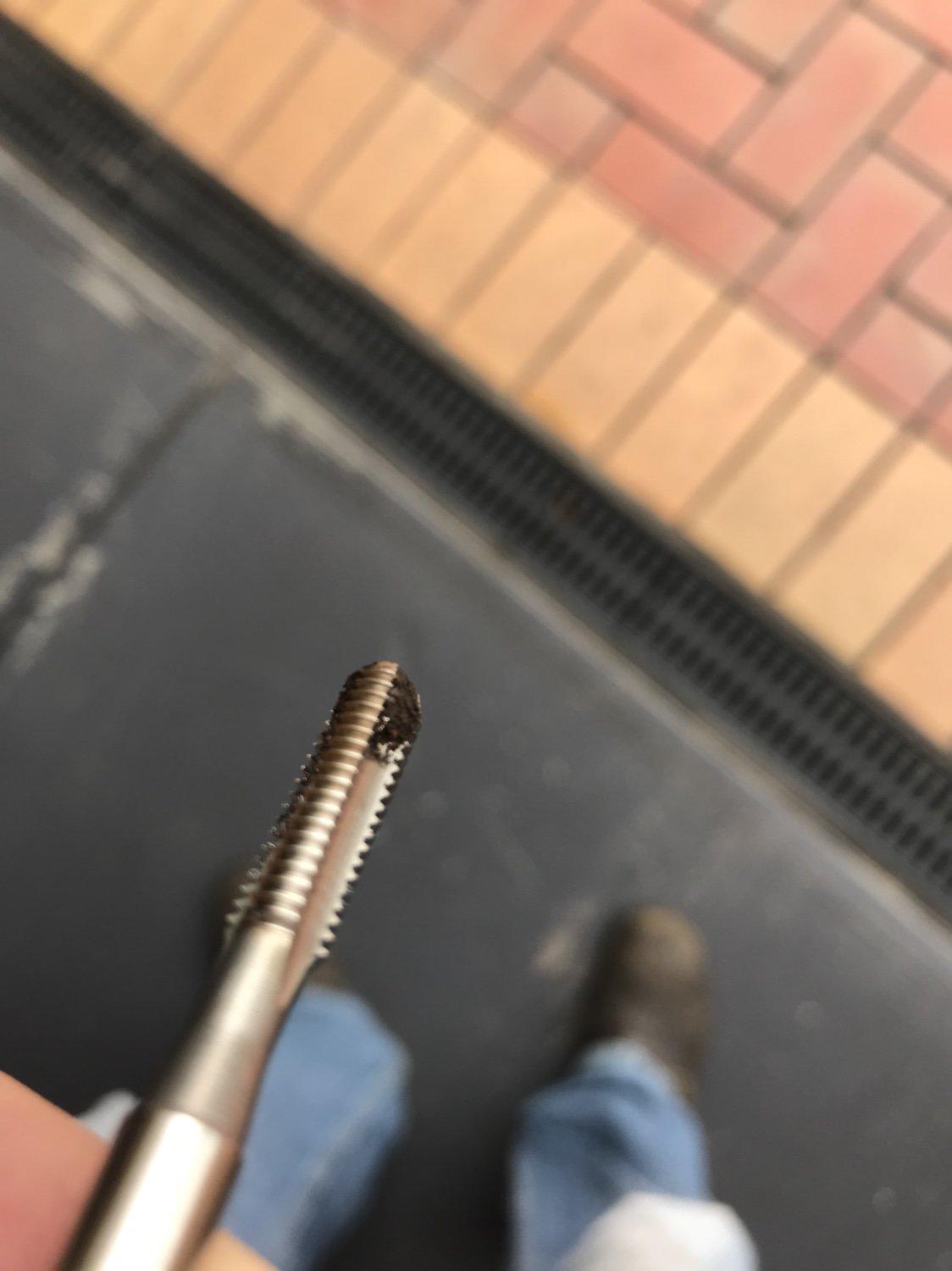

    Anyway so I got onto the other side today and bought a tap thing and all went on without any problems. It’s amazing how easy the bolts went in once the threads were clean.
    This is what came out!!
    Dave.
