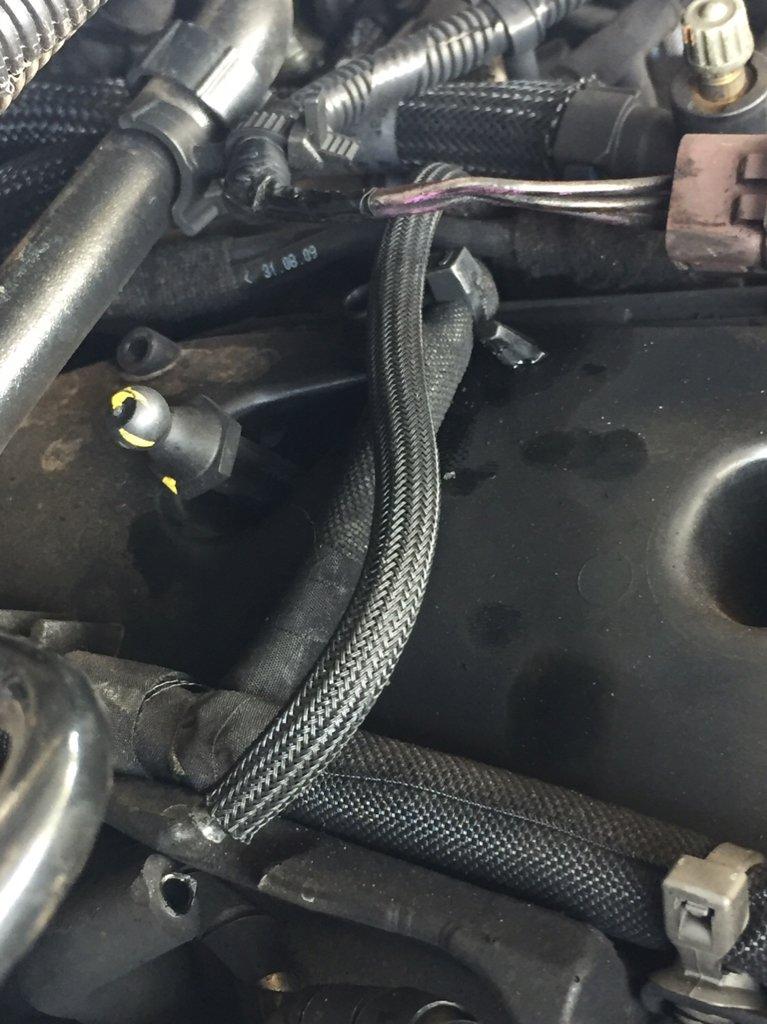

    Found a broken line that goes from near cylinder two to a plastic box behind the oil filter. What is this? And could it be causing my problems?
    Ean Austral Guest
    On my D3 it looks like a similar hose but its rubber, seems to be some form of air hose, could just be a pressure equalise of some sort. I would say that is most likely the noise you can hear . There's not oil everywhere so it seems like its not a oil line.
    Don't like your chances of getting that replaced with original here in Darwin , maybe a hose that 1 of the hydraulic hose mobs could make for you.
