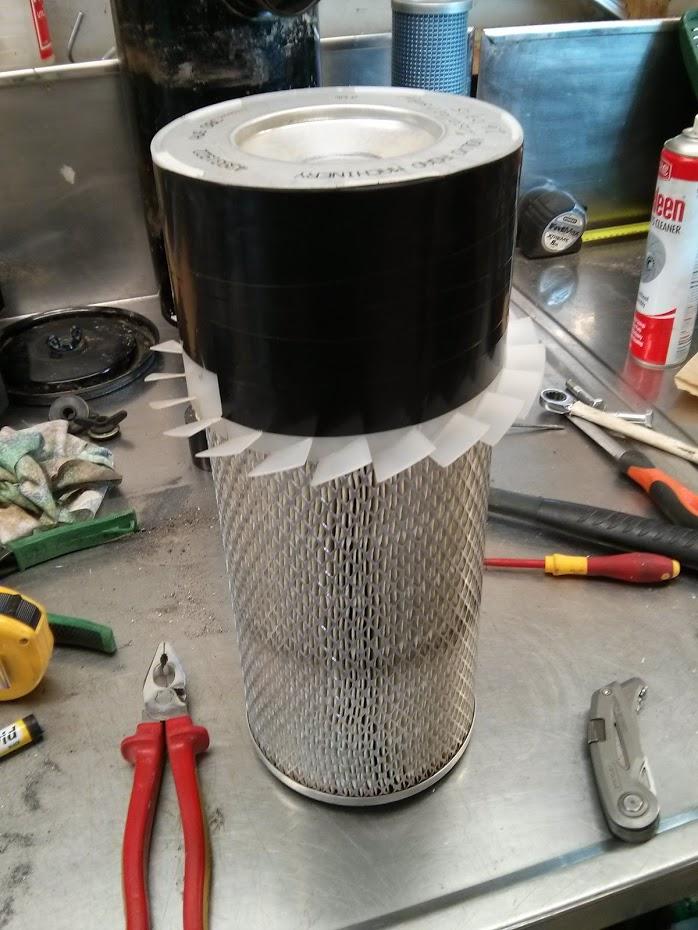

    Hey Paul, I think you are after a 6x6 filter
    Filter Kit to service Ex-Army Land Rover Perentie 6 x 6 | eBay
    Or you could just modify a standard one like I did

    Yes that is the 6x6 filter. Same filter as the 4x4 except the cyclone plastic bit is on the other end.
    Cheers......Brian
    1985 110 V8 County
    Jun 2014
    Waitakere, New Zealand
    1,270
    Quote Originally Posted by Bearman View Post
    Which can be achieved by removing the cyclone bit and putting it on the other end
