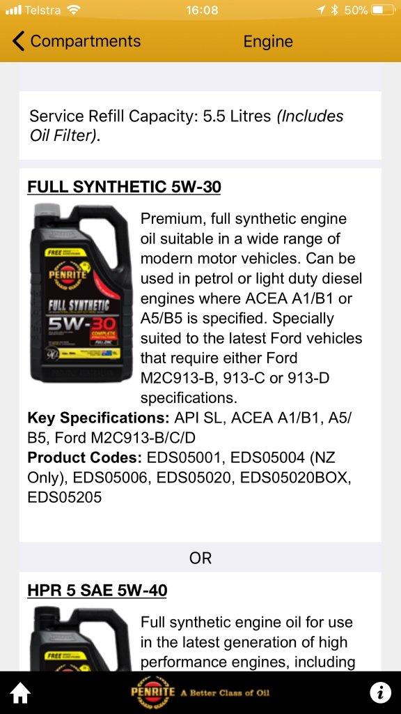

    Ah, under Everyday oil. Sorry, my bad. Good to know this option exists as well.
    2007 Audi RS4 (B7)
    As per their recommendations:
