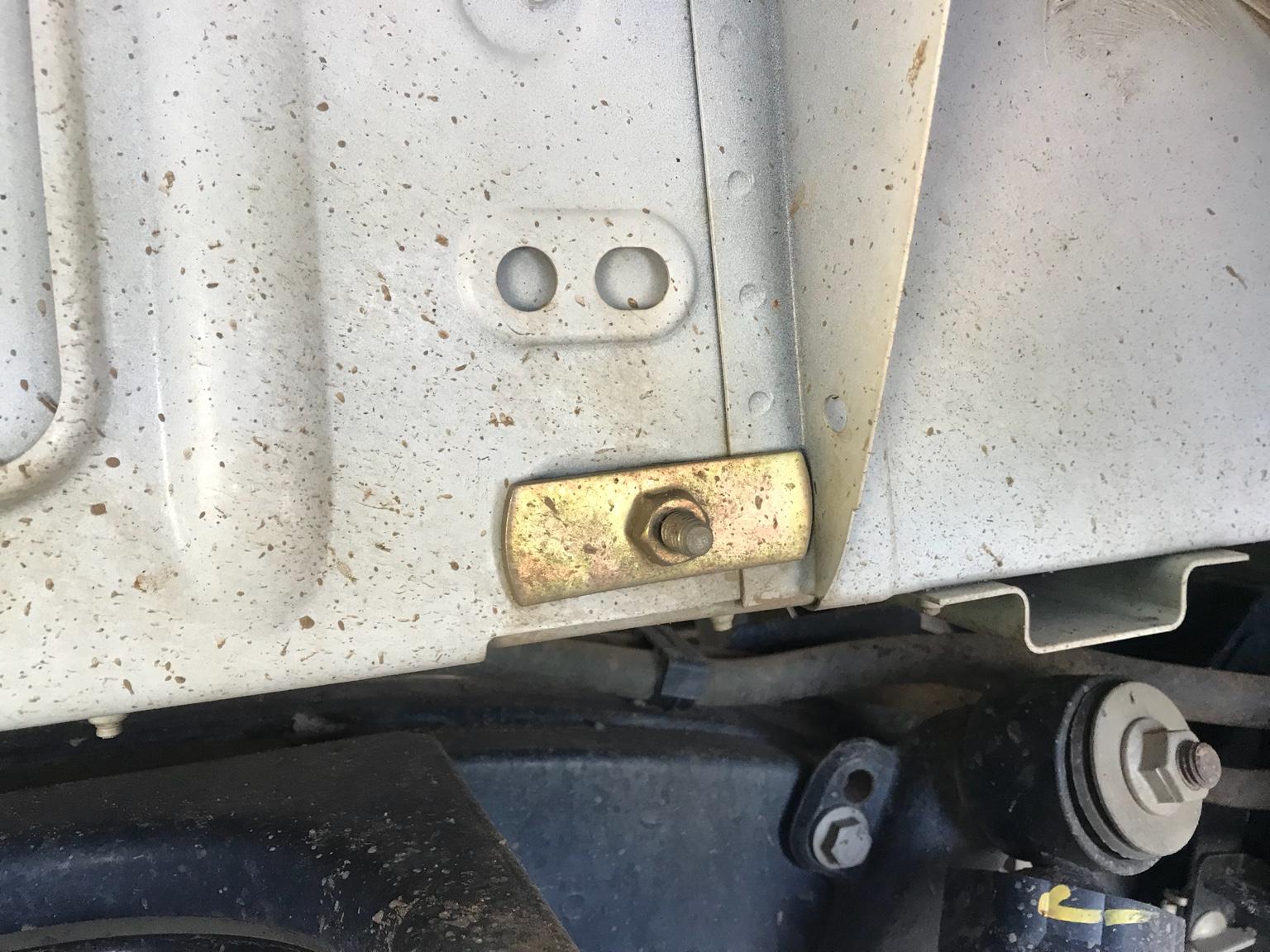

					I got two put in a 2017 110 in Brisbane 2 yrs ago. I can’t remember the company but they replaced two load tie down points adding a metal plate on the outside. Got the eng cert somewhere so will try and get the name of the mob that did it.

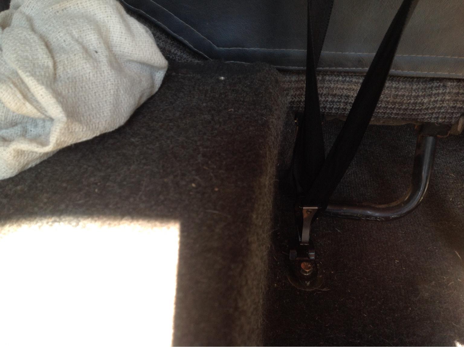

					I went to get a crab bar fitted to my 94' Defender. The fitter asked why I wanted to go with one. He suggested that he could fit two brackets to the floor where the seat belts are.  He stated that if the fitting could support the seat belts, it could handle the child support.
 So I got Two fittings and an engendering certificate. Very pleased with it - and the the grand kids are devoted Land Rover fans.
