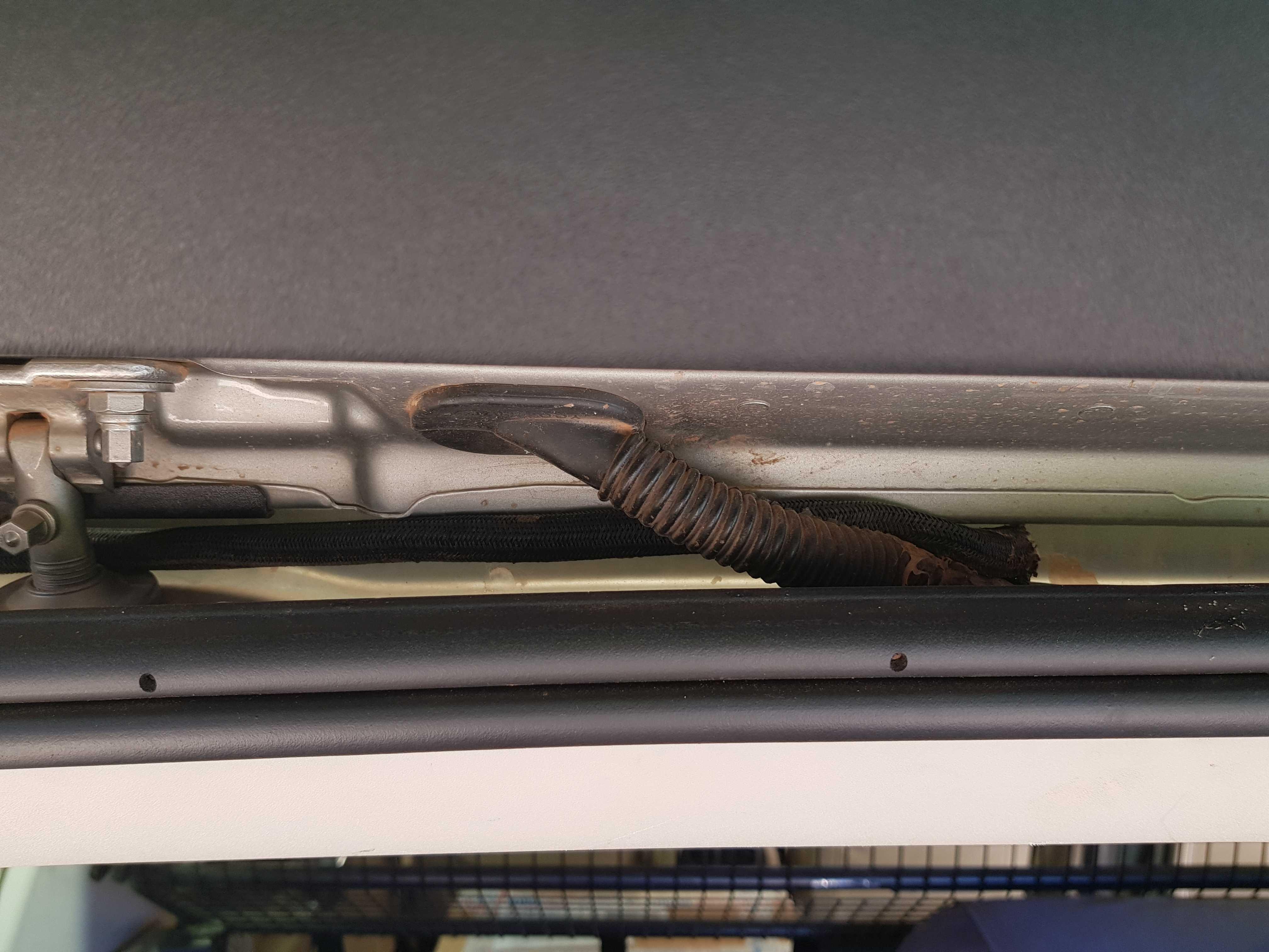

    I've done both:
    Tombie's way for my RFI antenna.
    Through the grommet in the upper tail gate for a CB antenna (unit located in boot side compartment) and power for 2 lights. There's only so much cable you can run through either so choose wisely for if you plan on running an antenna up there too.
    Running power from the rear was the obvious choice for me as it was already there thanks to the traxide kit with cigarette lighters to tap into with always on power from the aux battery.

    Like so. Bit if silicone to seal it back up before running this flexy conduit over the top.
