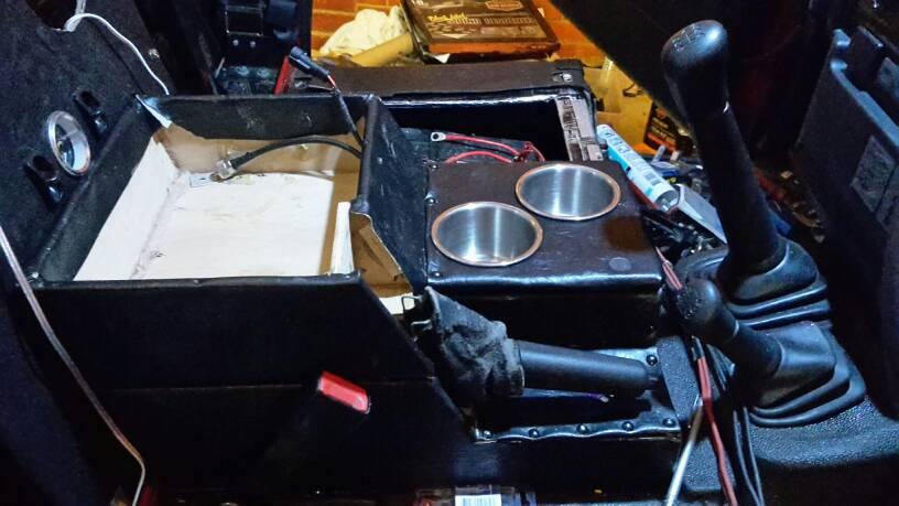

    Ive been slack and not taken photos of it finished. But the handbrake relocation was well worth the effort. Decent cup holders in the custom centre console as an added bonus.
    Why? Dont like the original up against my leg and dont find using it as a foot rest comfortable.

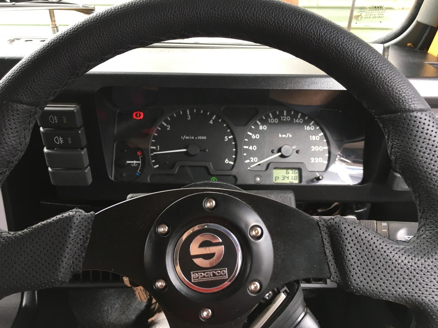

    Defender 5 Gauge Dashboard - YouTube

    EXCELLENT job on the dash, one of the best I've seen, looks O.E.
    Only thing I would have had, if it were mine, is that I would've had a tacho replacing one of those gauges.
    Top job, Pickles.

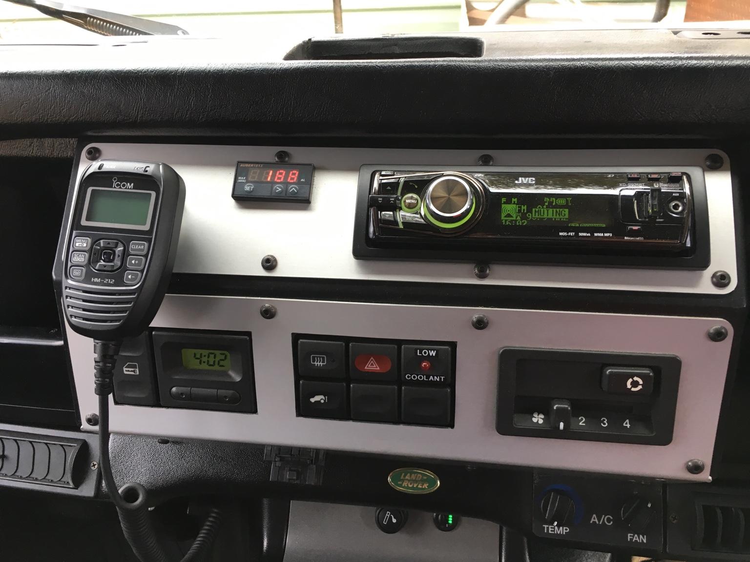

    Raptor Centre dash and D2 dash.

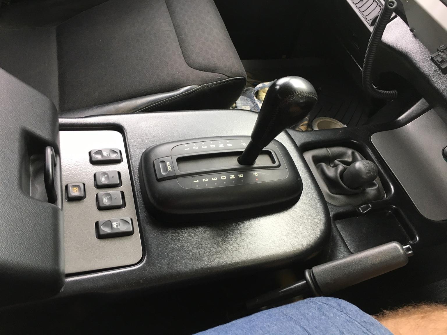

    D2 indicator and wiper stalks along with all other D2 functions.
    NAS spec console.
