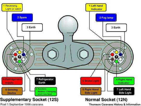

					Check your wiring... the plugs are slightly different to conventional.
 Note the D4 plugs are rotated 90 degree to the image.

					If all other lights are working correctly you have a problem with pin 2. There is a fuse box in the LH rear corner which has all connections for the trailer plugs, so that's a starting place.
