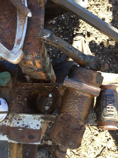

    After working on removing the steering relay for about 10 days I finally got it out this afternoon!
    I had used a jack, litres of lube, and dented the cross member trying to lever it out with a crow bar. No luck - not even a fraction.
    Today I put a large two leg puller pushing the shaft upwards. Then with a big copper mallet I had from my MG racing days I beat the sides, constantly putting more pressure on the puller. Well, almost to my amazement it started creeping out.
    It never got easier, fighting back right to the end! ‘Rite of Passage ’ complete
    Now I have nothing on the chassis except the hangers for the springs. The chassis is better than I had hoped with only the back crossmember needing work.
    Just thought I’d share my win.

    Removing a steering relay does test your strength & ingenuity. I've done 4 now and only one was a struggle but I have another couple to go so at least one of them will be a problem.
    As has been covered on the forum before, you can overhaul in situ if it won't come out.
    I have wondered whether an O-ring round the top would stop dirt/mud/stones etc. filling up the gap but I won't be removing any of the ones I've done in the near future.....

    I’m with you Colin - I’m not about to remove it again! I thought about servicing it in situ but didn’t like it beating me.
