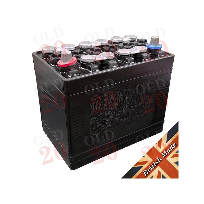

    I got a proper Rubber case battery, with exposed cell connectors & pitch top made for mine from Ariel Batteris , Clifton Hill .
    Was about 30 years ago but I'm sure they still make them.
    just like this one
