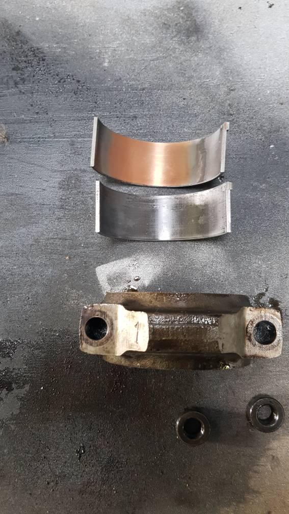

    1 and 4 conrods done. Onto 3 and found this (see photo)
    First four shells out the bag were as expected and fit fine (plastiguaged), the last four have a hole in them. What have I got here?

    First things first, never replace one half of a bearing! All the oil will tend to migrate to the loosest part, and starve your nice new bearing shell of lubrication, ensuring its' early demise.
    The hole is for oil to flow through onto the bearing face.
    The tab is to locate the bearing shell within the conrod big end. If you are only replacing the bottom shells (bad idea!) then those shells are for the top side. Push a conrod and piston up the bore a bit, and you should see the cutout and oil hole in the existing shell. The shells can only go in one way, due to the tab.

    Erm, look at my earlier photo of 1 + 4 bearings removed. No holes top or bottom.
    The last four shells in the bag were inline to service conrods 2 + 3, but they have bloody holes in them. Ive got the wrong set clearly.
    Jan 2010
    1,801
    OK so I ordered RTC2993 for my TDI but it looks like I received bearings for a 2.25 diesel (RTC7139)
    The 2.25 bearings have the hole on the upper bearing shell, the 2.5's are solid uniform.
    Supplier is telling me that I have the best bearings for the job, that the hole is of no consequence, and that I should install the holed bearing in the bottom position.
    What do you lot think?
    Narre Warren South
    6,792
    Quote Originally Posted by donh54 View Post
    In a hydrodynamic bearing the shells shouldn't touch the journal, the load is carried by the oil between the surfaces.
    The only time it should touch is on startup (no oil pressure). A worn shell bearing creates a bigger gap so the oil flows out more freely so you run lower oil pressure, plenty of lubrication but might be possible for the surfaces to make contact.
    The 'white metal' (Babbitt) surface is soft and any particles get embedded, long term the white metal is worn away down to the copper backing.
    The Science Behind Modern Performance Engine Bearings
    But I'd agree, you only change both halves of the bearing.
    From the supplier's comments the 2.25 has oil squirters in the conrods hence the hole to let oil up the conrods, doesn't the 200TDI have them ?? Looking at your pictures it doesn't so the supplier has suggested putting the ones with the holes in the caps so you get a full surface area in the highly loaded shells in the conrod. If they are exactly the same size I can't see a problem.

    Its of no consequence in a tdi... however in a 2.25 that hole MUST be there😅
