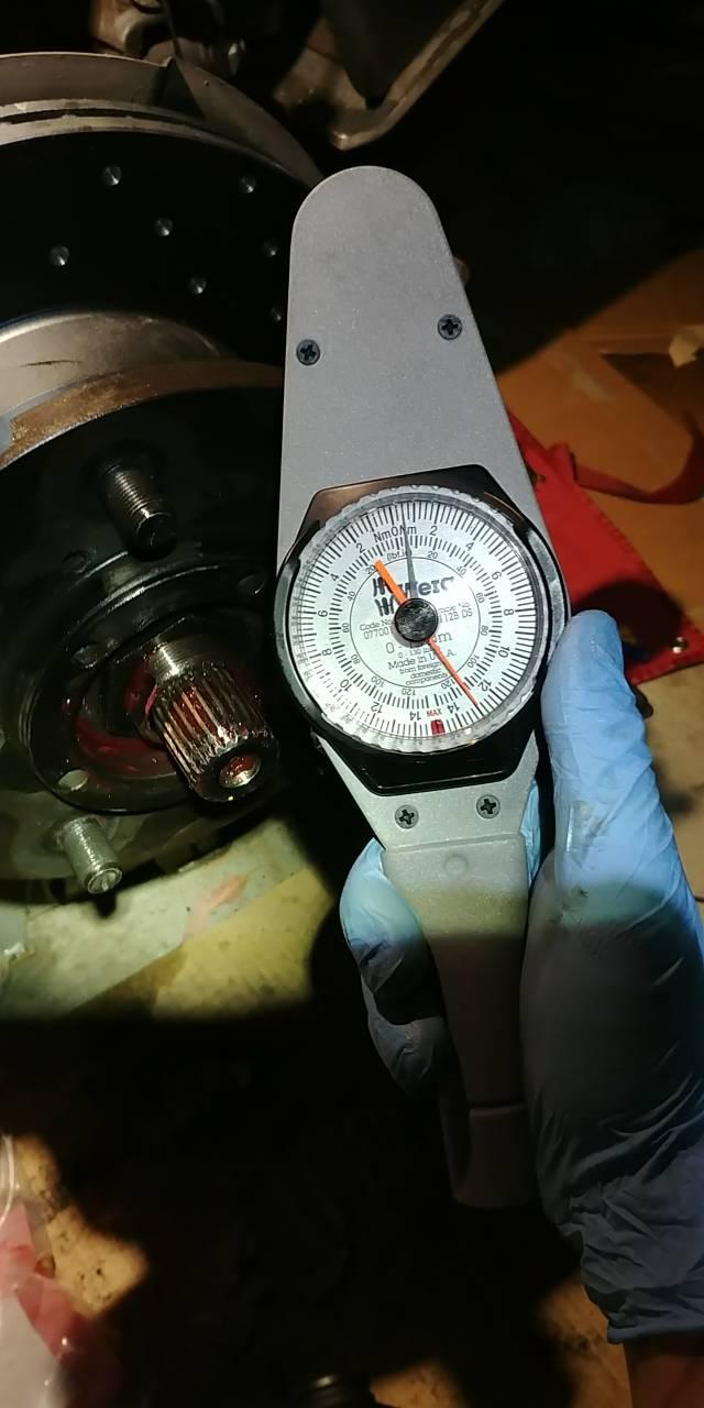

    When I did mine, I followed manual to use a dial gauge to check the end float.
    Well. Mine was not within spec. There should be no end float, but mine has.
    So I just convert the bearings to the old style two nut. torque to 10nm

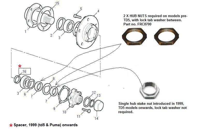

    New to PUMA's.... I naturally thought they were the same setup as the previous defenders.... can anyone post pics so I can see the difference?
    I assume this setup is on all 4 corners?

    This is the best Pic i can find at the moment, borrowed from Landrover Parts. Theres several different coloured spacers ranging from 14.9mm to 15.5mm. Ive repacked my bearings, front and rear, a couple of times, and so far haven't needed to replace them. On both ocassions, Ive just re used the spacer. Though I do have a set of bearings, and locknuts on hand for when either axle needs replacing.

    Thanks for that --- by removing the spacer, does that change the position of the outer bearing then?
