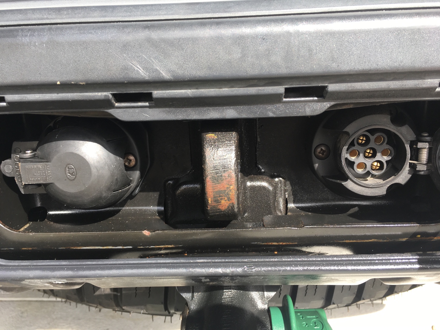

    Hi there. I have recently removed the white landrover trailer socket and replaced with normal trailer socket. This allows the use of a normal 7 pin trailer plug to be wired to an Anderson plug. I checked with multimeter and used pin 6 which is already fuzed at 15amp. I therefore use the right hand plug for normal trailer function and left hand (old white one) for anderson. Can also now wire compressor to plug in there. Here is all relevant photos if anyone is interested.

    Quote Originally Posted by MrFury View Post
    Thanks for the post. I use that white plug to run my solar panel thru and wanted to be able to hook my trailer battery to the car to help run my fridge.
    Good idea tho.
    Cheers Bulletman
    My compressor is 40amps of draw. No chance I’m of running it from that circuit.
