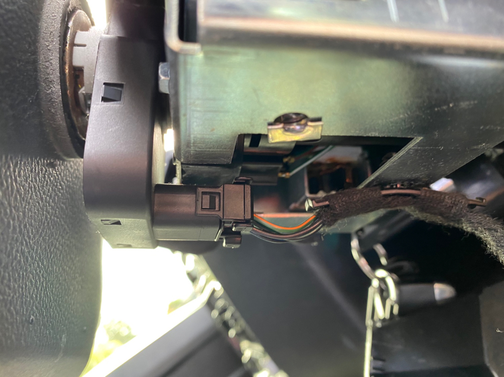

Thanks for the loom recommendations, I’ve got on of Tim’s SC80s and have been considering the loom for a while. My main problem looks to be the stability control as it means a different switch assembly is required ($80 vs $700!!).
I will take off the steering wheel on the weekend and see if the switch (not housing) can be swapped out.

						Supporter*Most last model Defender (2007 on wards) that I have had in with the no headlight etc issues its been the indicator assembly has broken.
*Two little claws by the stalk break off as does the little plastic bits close by.
*Often the indicators dont cancel.
*LR060124 is the last model Defender with stability control (well its fitted, just dont bet ya life on it).
*Its now round $500 and its available as OEM.
*XPB101290 is the one thats been used for 50 million years and is round $40.
*Its the main bracket that hold everything which is different and the centre plastic hub.
*I have already tried to swap over a indicator stalk from a early one but broke it (oh well down $40, will try again later).
*You need to engage the centre hub, the pivot pin for the stalk and get the 2 little claws to catch over the bracket, while also trying not to loose the tiny springs and the plastic ends.
