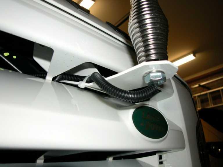

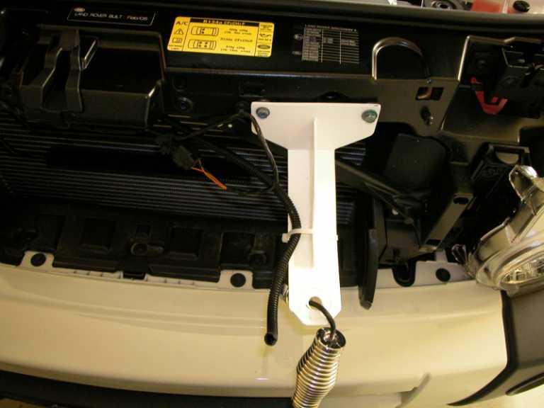

    I know of others who made a mounting bracket to fit their UHF aerial from the back pillar. Before I fitted the ARB bullbar I had a mounting bracket made up that protruded from the front grill and mounted exactly the same aerial as yours.

    I still have the bracket. You can have it (for a small fee) if you want it. PM me.
    Here are 2 pics

    I'm thinking that the bracket that PCH looks like a goer...
    Anyone know where to get them from? or is something I should just fabricate up myself.
