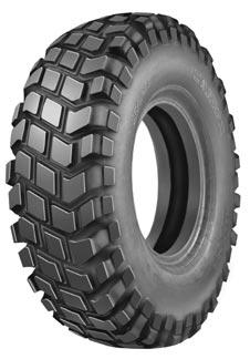

    Yes the Alliance Traction Lug look very much like the tyres on the Unimogs. Chalmers Truck Tyre service in Sydney - the local supplier gave me a quote of $380.00 each this week. (I think they are used by the Israeli Military - they are an Israeli manufactured item.)
    The thing that is putting a spanner in the works is that most cross-ply tyres are only a G speed rating which is 90 KPH. Ag Tyres in Moree, the MRF importer, suggested the Sand Grip....
    ... until they checked their regs and tell me that it is illegal for a tyre service to fit a tyre with a speed rating of less than 140KMH to a four wheel drive. (Wow would I feel safe traveling at 140KPH in a forward control? )
    The Michelin XZL 255/100 R16 are a radial tyre but it still only has a speed rating of 100 KPH which I think one would get away with.
    Now I have to go and check what the Alliance rating is.

    Yes they do do a bar tread in the smalles sizes 6.00 16 for sure because I have them, and I believe also in the larger sizes. However if one intends to do long distances a compromise tyre would be ideal. Triangle, a Chinese brand have a highway lug pattern in 9.00 16 listed in their catalogue.
    It is a bit similar to the old All Purpose Lug (Olympic I think) but so far I have not found a Triangle importer who bring it into Australia.
    My local tyre service (Cooke's Truck Tyre Service Nowra), suggested that Triangles used to be quite poor quality however that has recently improved and no complaints from customers in the last little while. The 8.25 16 was about $200 last time I asked.
    If others are interested, a group order may be possible. I have also recently heard that Beaurepaires are another Triangle importer, so my next stop will be them.
    Would anyone else be interested in a Highway lug on a 101 or 109/110 F/C?

    Unused Michelin's in Newcastle
    Hi people
    In my searching for tyres I have come across a bloke in Newcastle NSW who used to have 9.00 16s on his truck. He has 7 tyres which he describes as being bought then put in the shed for when he needed them.
    He says they are Michelins and describes a set of four as coarse tread mud tyres. I am assuming Michelin XZL:
    The Michelin XZL 255/100 R16 are a radial tyre with a speed rating of 100 KPH.
    He also says he has 3 highway pattern tyres, also Michelins I am assuming XZY the only other 9.00 16 Michelin made and which are not imported anymore.
    He paid $600 each tyre for them and was looking for someone to make him an offer on the lot (7 tyres).
    At present I was only looking for 2 tyres , and would be happy with the highway tread for the front of my S2B so would take the XZY depending on condition.
    Is anyone else interested in making an offer on the four XZLs before I close any deal I will check the tyres are what he suggests.
    send me a PM.

    The Michelin XZL 255/100 R 16 is dual branded (9.00 16 equivalent) and has a specified diameter of 923 mm
    The Triangle have a spec. of 905 mm for their 9.00 16 lug.

    I just used a tyre calculator and punched 9.00x16 in and it came up with 866 - close enough to 900 for govt work. I appreciate actual 9.00x16 tyres might have a slightly different rolling dia.
    So any tyre about that dia with the correct speed rating and load rating should fit - maybe will be a little wider than the the standard lugs. 35" tyres are also about the same size as well.
    Most of the other tyres I have looked at on the net at about 900 dia have a Q speed rating which is good - like you I am not keen on even doing 80kph in the rain on conventional lug tyres.
