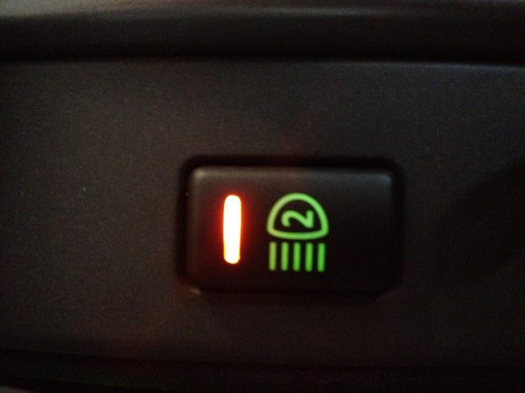

    Hi, Thanks for the info, as I just bought a set of driving lights myself. I have just a few questions, How do you run the wires to the dash switch? and, Do you have a photo of the dash switch? It must be quite special for a $100, when I can buy a generic switch from Jaycar for about $5. I would just like to see it because I do have a thing for genuine fittings. Thanks.

    As with most things any OEM part seems expensive. Decided to use the LR part instead of the switch supplied with the loom as it looks a lot nicer then the mouse style one (see photo).
