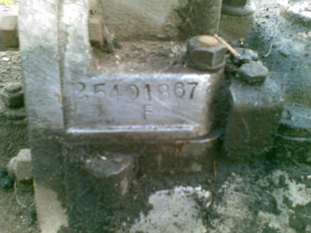

    Would the gearbox gurus be able to tell me if this box from my 1970 2a donor is syncro or not?

    The top cover at least is a SIIA, suffix F box, so non synchro.
    But the top covers can be swapped...
    I think only some/all of the suffix H boxes had synchro. Your box is a few years before that though.
