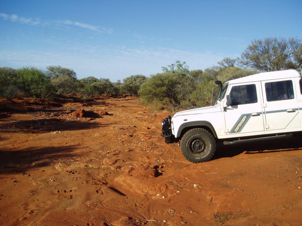

    Hi 265/75/16 will be around the same rolling diameter as your standard 235/85 tyres you are already running. If you wanted to keep the original rims but get your extra clearance you will need to go to a 255/85/16 size. The only makes that do them are BF Muddies and Bighorns., I fitted the 255 bighorns two months ago for around $270 each and I am very happy with them. They seem to be good on the road, a little noisier than any A/T tyre on the market and brilliant in the rough stuff. The 255 tyre gives you around a 33inch diameter tyre.
    cheers matt
    here's a pic of the bighorns on my deefer

    Thanks Matt...
    Am very inclined to take on your advise...cheers Ned
