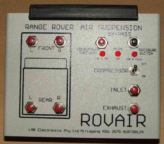

    Does anyone have one of these or know just
    what it actually is capable of doing ?
    link here ROVAIR
    I assume it can't rectify a leaking valve, only computer faults ?

    Dont know, never heard of it, but now i'm interested.... Was going to make one of my own.
    Shame theres no pics or other info on it though...

    The basic ROVAIR won't cover a leaking valve block but the ROVAIR PLUS does I believe. Lee spent a lot of time developing this bit of kit & it's very good.
    Give him a call. He'll be more than happy to have a chat to you about it.

    I've got one. I won it at Cooma, Easter 2008

    .......and , and ......... give us the lowdown on it please Ron.
    Northern Windowlickersville WA
    3,403
    Classic and P38??
    30,806
    It replaces the computer on either the Classic or P38A.
    Unplug computer, plug this in and manually control compressor operation as well as inflating/deflating the air springs.
    I've only used it to get PaulP38A home from Sydney to Canberra.
    If the valve block is leaking, this version won't help.
    Up a hill in the deer park
    662
    Can it be used to select a "ride height" by pumping up until you
    stop it increasing height (manually) at a desired level ?
    30,806
    Quote Originally Posted by Neil P View Post
    Yes. It comes with a tape measure so you can adjust the heights to be same at all corners.
