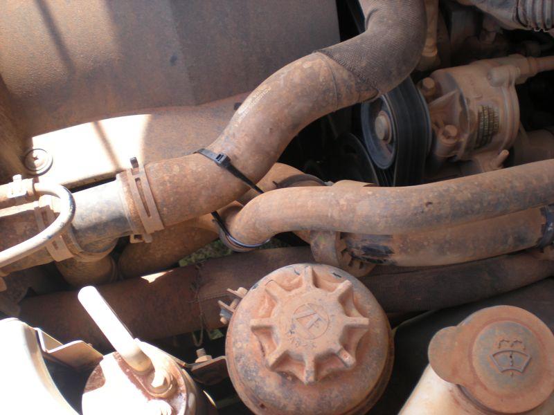

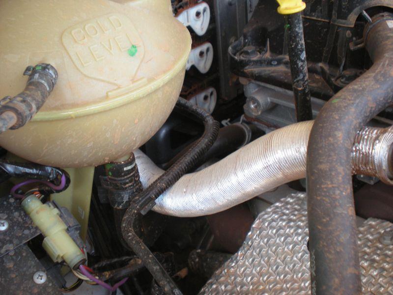

    This one I've loosely cable tied up as the smaller hose was rubbing against the power steering reservoir. You can see I've also repositioned the rubber block to move the larger hose off the same reservoir.

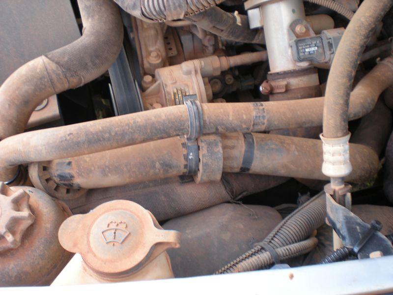

    In this case (just back from the one above) the clamp was rubbing on the lower hose as it was positioned outside of the cloth abrasive sleeving. I moved the block back and the clamp forward.

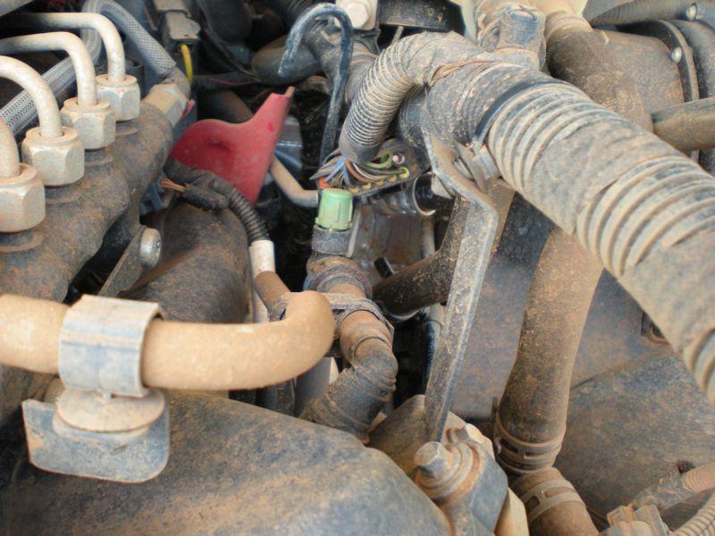

    Wire under the new conduit I tied up to the bracket. It was sitting against the air-conditioning bleed block.

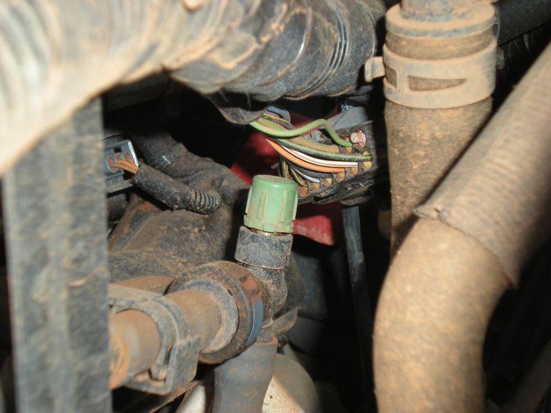

    I'm a bit worried about this wiring block, but at present can't seem to work out a suitable way to move it away from the other stuff.

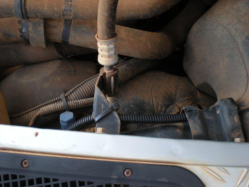

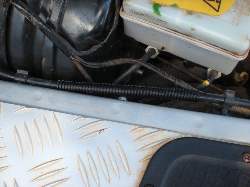

    This conduit now covers the coolant line that rubs against a bolt head on the edge of the guard. Also in this picture you can see a small rub mark starting on the brake fluid reservoir.

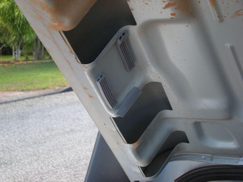

    Lastly my take on remedying the rubbing brake fluid reservoir until I can get to the dealer in 3 weeks time (and about 4000km).
