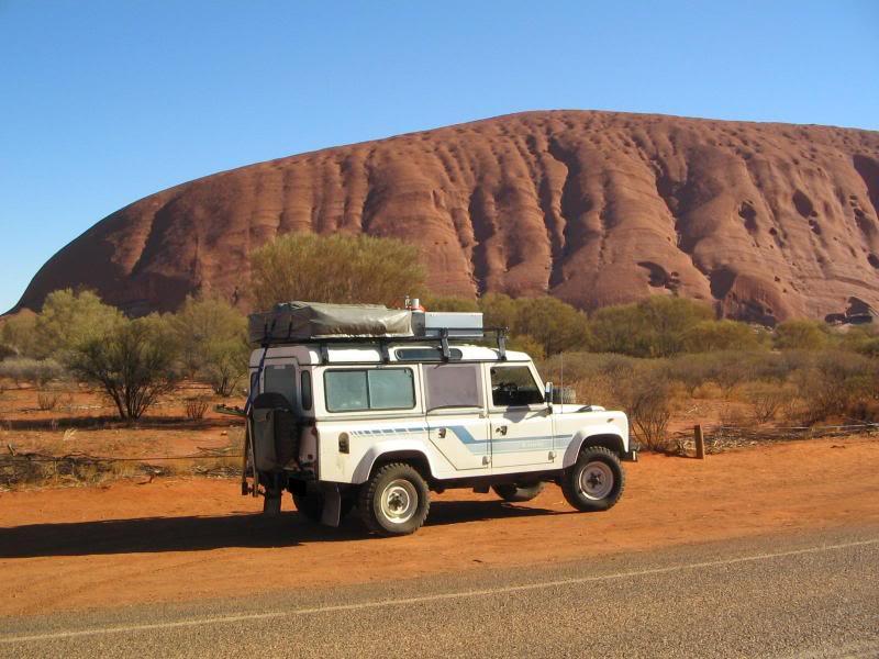

    here is a pic of mine.....one does have to be aware of all the additional weight....
    on my last trip i had 3 x 20L jerries, spare tyre and rim, 3 x swags, 2 x gas cylinders, awaning, solar panel plus a few other bits and pieces (fold out toilet, tarps, rubbish, garden hose, shovel)
