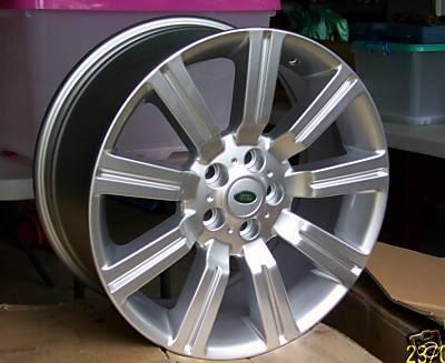

    and i scored a set of 20" wheels for it ... any tyre recommendations??
    We had a Sport here this week with 20" Cooper A/Ts fitted. It looked the goods .

    [QUOTE=ozducati;1023843]and i scored a set of 20" wheels for it ... any tyre recommendations??[QUOTE]
    Congrats on the deal.
    Just make sure when u do get tyres they are the "right" size.
    The sport has 275/45/20 from memory, the disco will need 275/50/20 to get the tyre rolling diameter the same as the original tyre.
    The fun part is going to be getting a tyre as this size may not be popular..for a Disco anyway.

    275/50/20 is O/D 783mm, 275/45/20 is O/D 756, 255/60/18 stds are 763. So 275/45/20 is closer and 275/20 is +20mm which is not legal in Victoria.
    You can find 275/45/20 tyres from Bridgestone, Continential, Cooper, General Tire, Maaxis, Michelin and Pirelli, all load-rated 109 or 110 which is sufficient for Aussie D3s.
