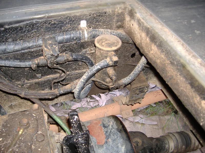

    My fuel pump and you will also see the fuel cut out for the LP Gas just in front of the pump on the chassis.
    Above the petrol line is the LP Gas supply hose from the rear(wrapped in nylon)
