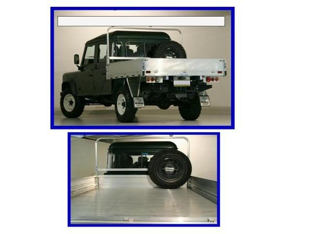

    Not too sure if it can be stored under, as the Fuel tank lives there, i have seen a number with the spare at the rear of the tray, as per pic..

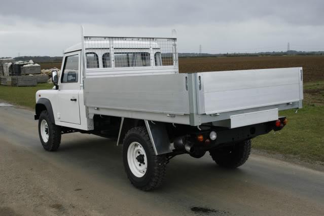

    However looking at these 2, iam not sure as one of them there seems to be no spare on it at all.seems to have no spare at all.
